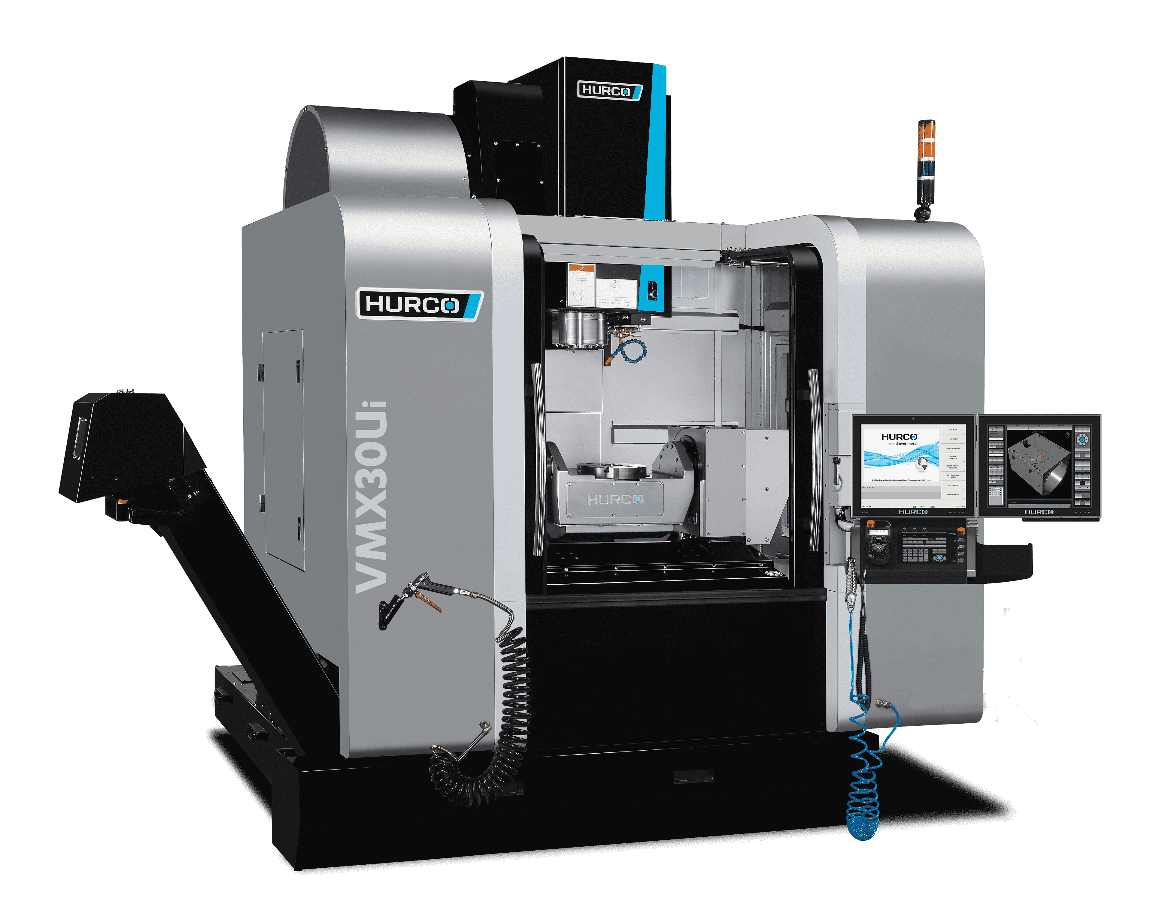

VMX30Ui Machine Specifications
Travels & CapacityX, Y, Z Axis Travel | 30 x 20 x 20.5 in (762 x 508 x 520 mm) |
| A-Axis Travel | +30°/-110° |
| Spindle Nose to Table (Min-Max) | 3.5 in / 24 in (90 mm / 610 mm) |
| Table Diameter | 9.8 in (248 mm) |
| Max. Weight on Table | 440 lbs (200 kg) |
| T-Slot Size | 6 x .48 in x 60° (6 x 12 mm x 60°) |
| Max. Spindle Speed | 12,000 rpm |
| Peak Spindle Motor | 15 hp (11 kW) |
| Spindle Torque (peak - 1 min) | 157.3 ft. lbs @ 600 rpm (213.3 Nm @ 600 rpm) |
Tool ChangerTool Type | CAT 40 (CAT, BT, DIN 40) |
| Number Of Tools | 40 |
| Max Tool Diameter | 3.0 in (76 mm) |
| Max Tool Length | 11.8 in (300 mm) |
| Max Tool Weight | 15.4 lb (7 kg) |
FeedratesRapid Traverse X,Y,Z Axis | 1,496, 1,496, 1,260 in/min (38. 38, 32 m/min) |
| Max Programmable Feedrate | 1,260 in/min (32 m/min) |
| Rapid Traverse A, C Axis | 25 rpm |
SizeMax. Operating Floor Space | 155.1 x 159.8 in (3,939.5 x 4,058.9 mm) |
| Machine Height | 113.3 in (2,877.8 mm) |
| Machine Weight | 10,868 lb (4,940 kg) |
ElectricalPower Rating/ Full Load KVA | 27 KVA |
