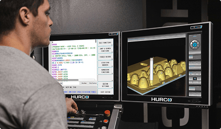

How to Set Your Hurco Control to ISNC for Use with the FANUC 0-M Postprocessor
Step 1
Press the AUXILIARY button on the control panel
Step 2
From the pop-up menu, select the UTILITY SCREEN icon
Step 3
On the console's touch-screen, select the USER PREFERENCES softkey
Step 4
Select the NC SETTINGS softkey
Step 5
Change the NC DIALECT to INDUSTRY STANDARD
