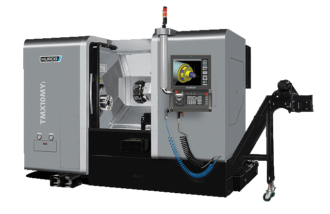

TMX10MYi
High Performance Turning Center with Live Tooling
The TMXMY/S mill turn lathes are true slant-bed lathes with all-digital drives and motors and absolute encoders on all linear axes. The addition of the Y-axis allows you to machine a pocket with straight walls and flat bottoms or perform off-center machining operations with just a click of a box.
