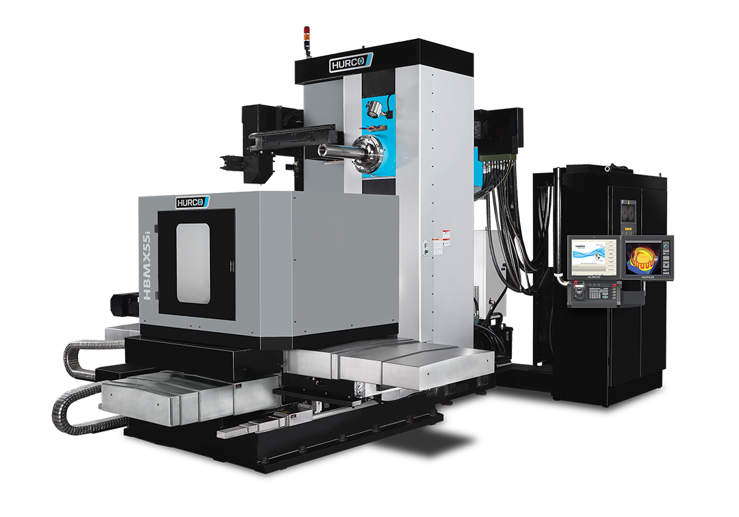

4-Axis Horizontal Boring Mill
The Hurco Horizontal Boring Mill provides a small footprint, large work envelope, and is heavier and more rigid than competitive boring mills in its class. The HBMX55i is equipped with a 2-speed geared spindle head and hardened box ways. The HBMX55i delivers a superior package that includes features you need for typical applications instead of requiring you to add them as options.
