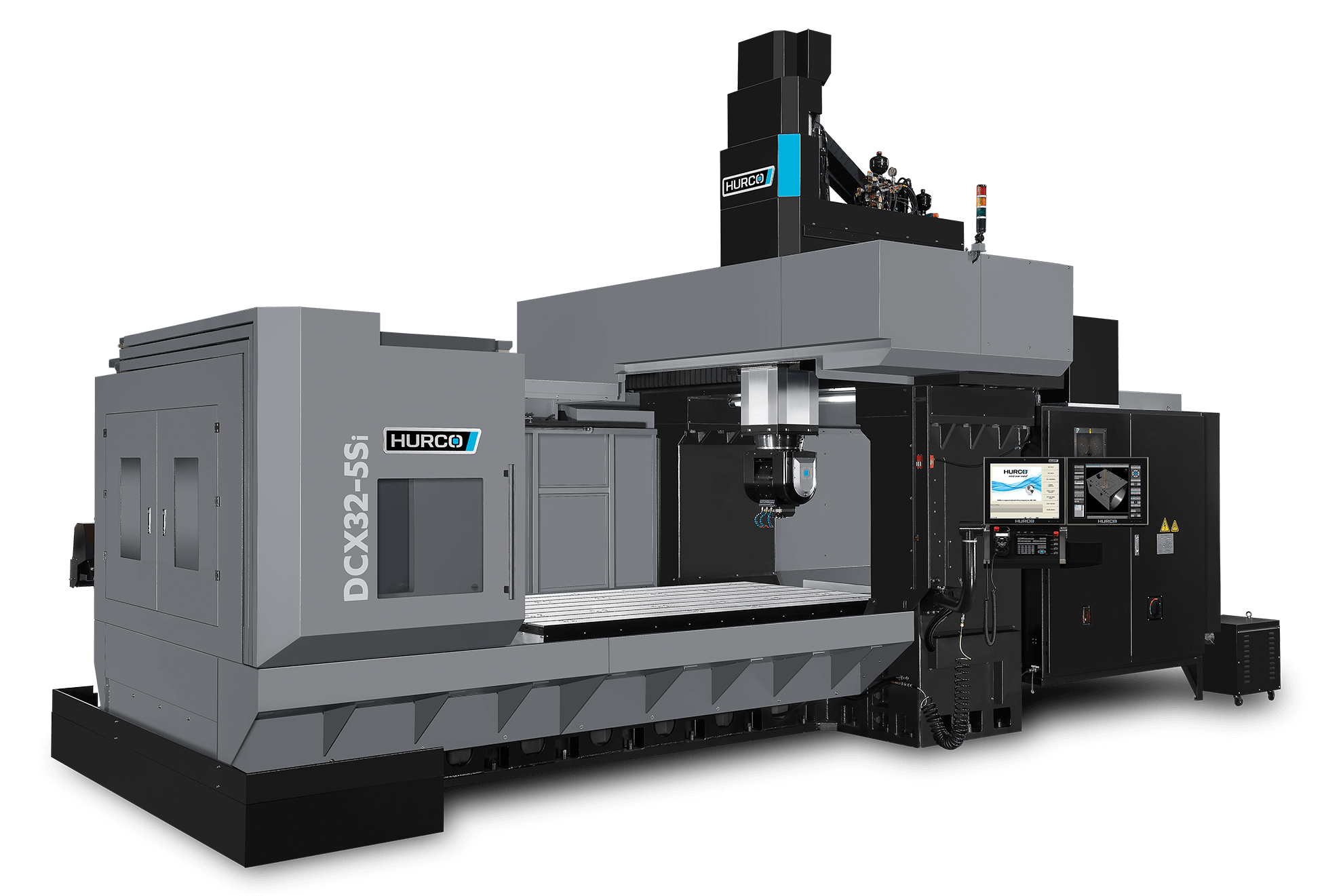

DCX32-5Si
The dual column DCX32-5Si is the only machine in its class with the integrated Hurco control powered by WinMax. The double column design provides superior dynamic behavior and promotes thermal stability. Our control technology combined with our stringent design and manufacturing processes make the DCX32-5Si is an excellent investment. Exceptional cutting feed rates are achieved with patented high-speed motion technology – resulting in the fastest cut with the best surface finish.
Request Price Scroll to Machine Specifications Find Your Local Distributor
DCX32-5Si -  - Hurco
DCX32-5Si Machine Specifications
Max Spindle Motor Torque69.3 ft lbs @ 5,700 rpm (94 Nm @ 5,700 rpm)
Travels & Capacity
X, Y, Z Axis Travel
126 x 82.7 x 35.4 in (3,200 x 2,100 x 900 mm)
Spindle Nose to Table min/max2.6 / 38 in (66 / 960 mm)
Table Size118.1 x 66.9 in (3,000 x 1,700 mm)
Max. Weight on Table24,250 lbs (11,000 kg)
T-Slot Size7 x 0.87 in (7 x 22 mm)
Distance b/w Columns83.9 in (2,130 mm)
B-Axis Travel+/-110°
C-Axis Travel+/-360°
Spindle
Max. Spindle Speed
18,000 rpm
Peak Spindle Motor75.1 hp (56 kW)
Tool Changer
Tool Type
HSK 63
Number Of Tools40
Max Tool Diameter 3.0 in (76 mm)
Max Tool Length 11.8 in (300 mm)
Max Tool Weight15.4 lb (7 kg)
Feedrates
Rapid Traverse X,Y,Z Axis
591, 591, 394 in/min (15, 15, 10 m/min)
Max Programmable Feedrate394 in/min (10 m/min)
Machine Height207.0 in (5,250 mm)
Required Floor Space393.0 x 268.3 in (9,982 x 6,815 mm)
Machine Weight82,982 lb (37,640 kg)
Power Rating/ Full Load KVA89 KVA
