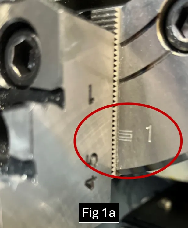

On the face of most CNC lathe chucks, you will see a visual scale or indicator that allows the operator to verify that they have their part clamped within a safe region of the stroke. This indicator is usually located on the face next to the #1 chuck jaw.
This indicator has two straight lines on the outer most edges of the marking, which indicate the full stroke limits of the chuck and a "U" shaped area within those marks. This "U" shaped area is the safe clamping section of the stroke limit.
How to Use the Indicator
  1. With the chuck jaws fully opened, find the jaw serration that lines up closest to the top straight line. This serration will be what we use to indicate where the part is clamped within the stroke limit.
  2. If you close the chuck, that same serration should land near the bottom straight line, indicating the full stroke limits of the chuck.
  3. When you have the part clamped properly, the serration we are using to mark the stroke location when clamped will fall somewhere within the "U" shaped area of the stroke limits of the chuck.
With the part safely clamped within the safe clamping zone of the chuck stroke limit, you can now run your parts. Now that the clamping zone has been established, you can verify the clamp/unclamp sensors that we discussed in the previous video.
