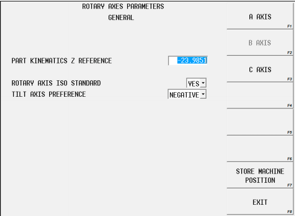

STEP 1: Find the C-axis Centerline
STEP 2: Determine the Y-Axis Offset Distance
STEP 3: Find the A-axis Centerline
STEP 4: Compare the values obtained in the steps above with the current machine centerline values for the A-axis and C-axis.
Click here to download the pdf with detailed description of each step
