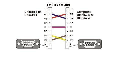

HOW TO HOOK UP A RS 232 CONNECTION TO A HURCO WITH ULTIMAX CONTROL. ALSO HYPER TERMINAL SETUP INFORMATION
9 pin Cabling - RS232
