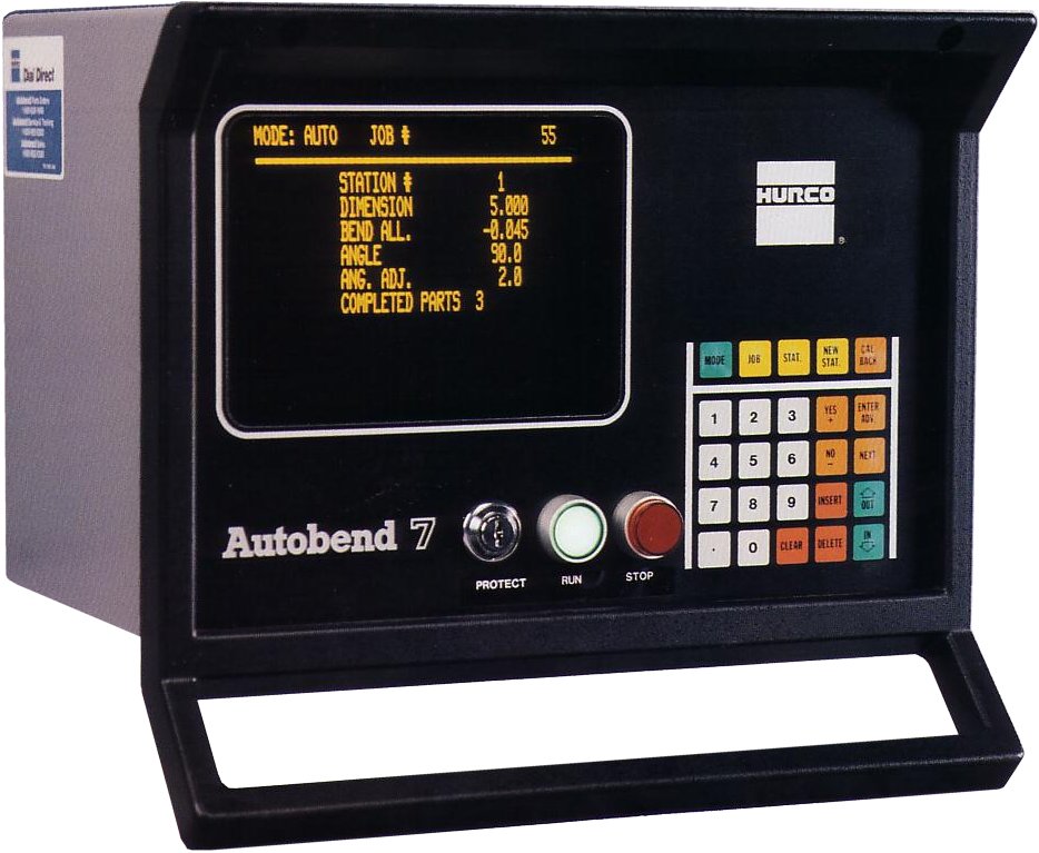

How to check out a PM SERVO MOTOR on the AB5/C, 6 or 7 Controls
Autobend 7
