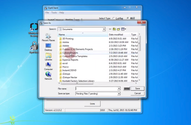

Select the request license codes button then go to the pending tab Click on the Save Pending File button Just name it whatever control type is mill/lathe Hit save to save the file to your desktop or another convenient location.
Email the file that was generated with a .pending extension to your Hurco representative.
