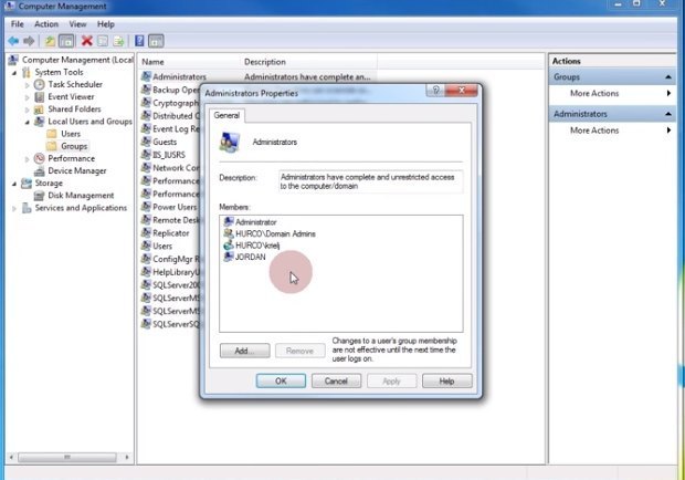

This setup requires administrative privileges that appear to be unavailable. Would you like to try again?
WinMax Desktop Installation Message
Why you received error: Installation of WinMax software requires you to have an administrator account, or with an account with local administrative privileges.
Solution: Click on the windows start menuWindows Start Menu Button the bottom left corner of the computer desktop screen. With the mouse, right click "computer" and then select "manage" from the pop-up menu. Select the local users and groups... groups... and then the administrators group. Note: your domain or local login username must be in here in order for you to be a local administrator. It's possible you will need your IT staff to help you with this.
