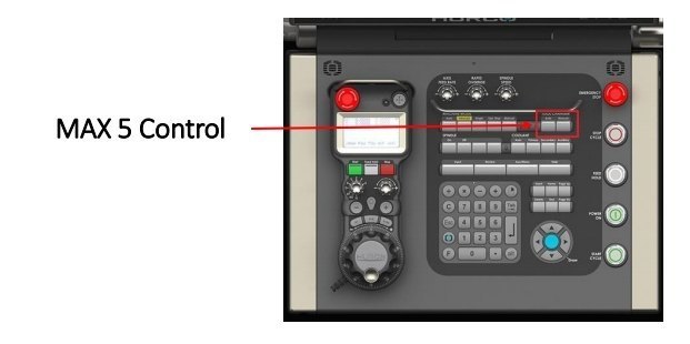

This document will help with getting you familiar with changing tools and setting your tools to Manual or Auto (in ATC). First, find the TOOL CHANGER hard keys on your control. The AUTO hard key under TOOL CHANGER is what we will use to initiate tool changes.​
