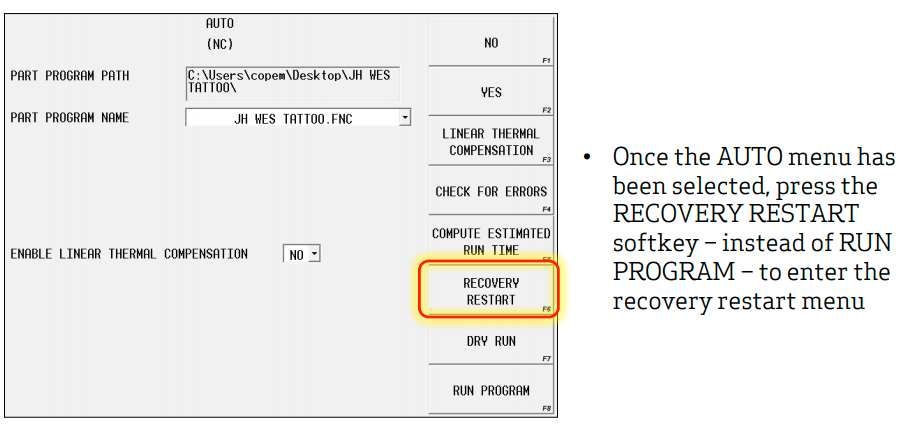

Recovery Restart is a way to restart a program – either conversational or NC – in the middle, without the need to enter extra code or start on any particular line in the program.
Simply cursor to the line you wish to start on, manually set or auto set the restart marker, and press START CYCLE to begin machining.
The control will buffer any necessary modal codes from the program, above the location where the restart marker was placed, and begin movement from the desired location.
A Recover Restart is a single-shot execution, and will disappear once the program has been completed – meaning that the program will begin from the beginning of the file the next time it is started.
