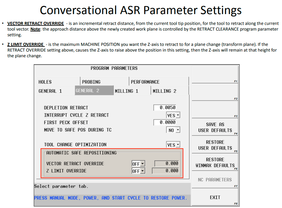

What is Automatic Safe Repositioning and how do I change the Conversational ASR Parameter Settings
Conversational ASR parameter settings
