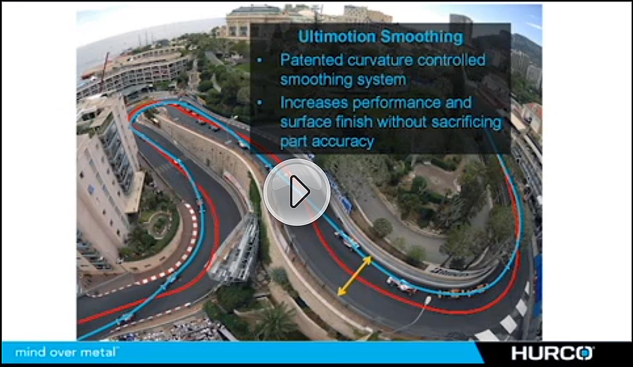

Surface Finish
The engineering team at Hurco refers to UltiMotion as soft motion because the software controls the motion control system versus a conventional motion control that relies on hardware. The software is more efficient in how it processes the motion so there is less chatter, less vibration, less machine jerk, which results in better surface finish.
