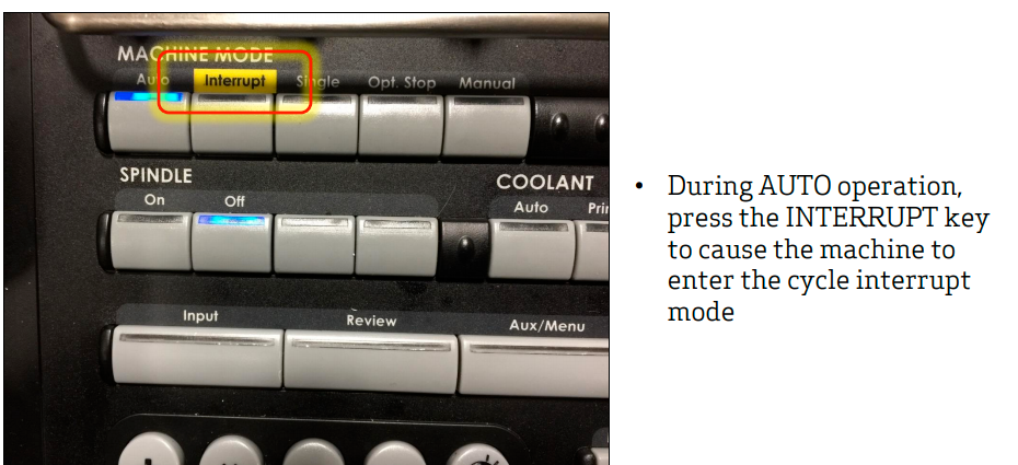

​Cycle Interrupt can be used anytime the operator wants to suspend the automatic operation of the machine – in either conversational or NC programs – and place the machine into a semi-manual mode.
During a Cycle Interrupt the machine can be manually jogged – in any axis – to any desired location, for any reason. Once automatic operation of the machine is required again, the operator can simply press the AUTO mode key, followed by the flashing START CYCLE button.
The machine will safely resume the previous operation from wherever it was interrupted.
