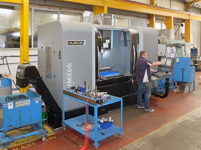

The 3-axis Hurco VMX60Ti, with its 40-taper, 10,000 rpm spindle and 1,524 x 660 x 610 mm work envelope, weighs nearly nine tonnes. It machines PAB’s press tools comfortably to accuracies within ± 0.015 mm. During 2016, it produced 20 per cent of the subcontractor’s tools, helping to manufacture more than one million components shipped that year. In the first half of 2017, the proportion of tools made in the Coventry facility rose to around 35 per cent and Mr Brazier predicts that it will eventually increase to more than half.
Additional duties of the latest machine are the manufacture of inspection fixtures and composite tryout tools, milling and drilling of large parts such as door sills, and production of smaller components such as bosses and machine pins if the other machining centre is occupied.
As far as programming is concerned, the complex surface profiles of most press tools require off-line preparation and downloading of machining cycles, in PAB’s case using a seat of OneCNC software. However, for simpler jobs like milling of inspection fixtures and tooling plates, maximum advantage is taken of Hurco’s WinMAX conversational programming software resident in the proprietary twin-screen control. The second screen allows a graphic of the component to be viewed and checked as it is programmed on the shop floor.
