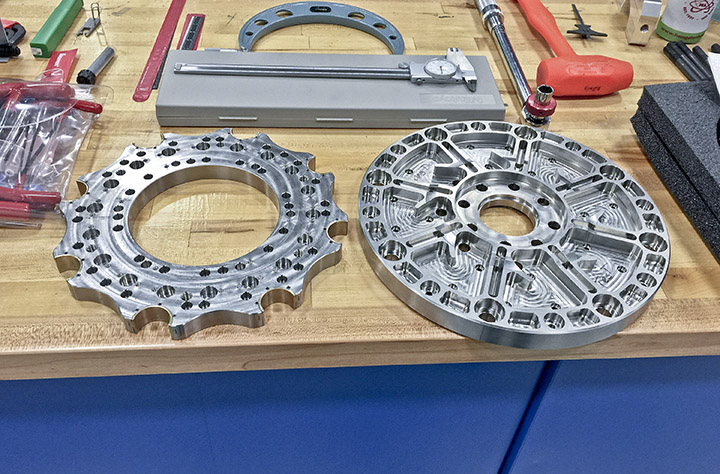

Parts-Clutch-Flywheel-Pressure-Plate-VMX6030i-web.jpgJohn Force threw his complete support behind the project by opening a state-of-the-art machine shop at the team’s newly built 180,000-square-foot facility in Brownsburg, Indiana. Eric’s father, John Medlen, became project manager of the Eric Medlen Project and worked with Ford Motor Company, the NHRA, SFI, chassis builder Murf McKinney and a host of others in an unprecedented display of cooperation.

FAM manufactures tens of thousands of parts per year that range from small consumable parts to super chargers, engine blocks and cylinder heads. Approximately 90% are 7075 and 7050 aluminum and the other 10% are Titanium Grade 9 (6AL4V).

“It’s a big deal,” Barnes said of the memory and speed with which the Hurco control loads part programs. “We have a flywheel part with two operations that we separated into two part programs because it would take 52 minutes just to load one operation before we got the Hurco. But now, with the Hurco control, it takes 10 seconds.” “And the memory is so great we can have multiple programs loaded instead of loading them one at a time,” said Barnes. The graphics display, called Advanced Verification Graphics, is another winning feature of the Hurco control, according to Barnes. “It just gives me peace of mind to know I can see the detail of what the tool is doing and know there aren’t any crashes. The display is really clear and offers different views on the DRO.”
