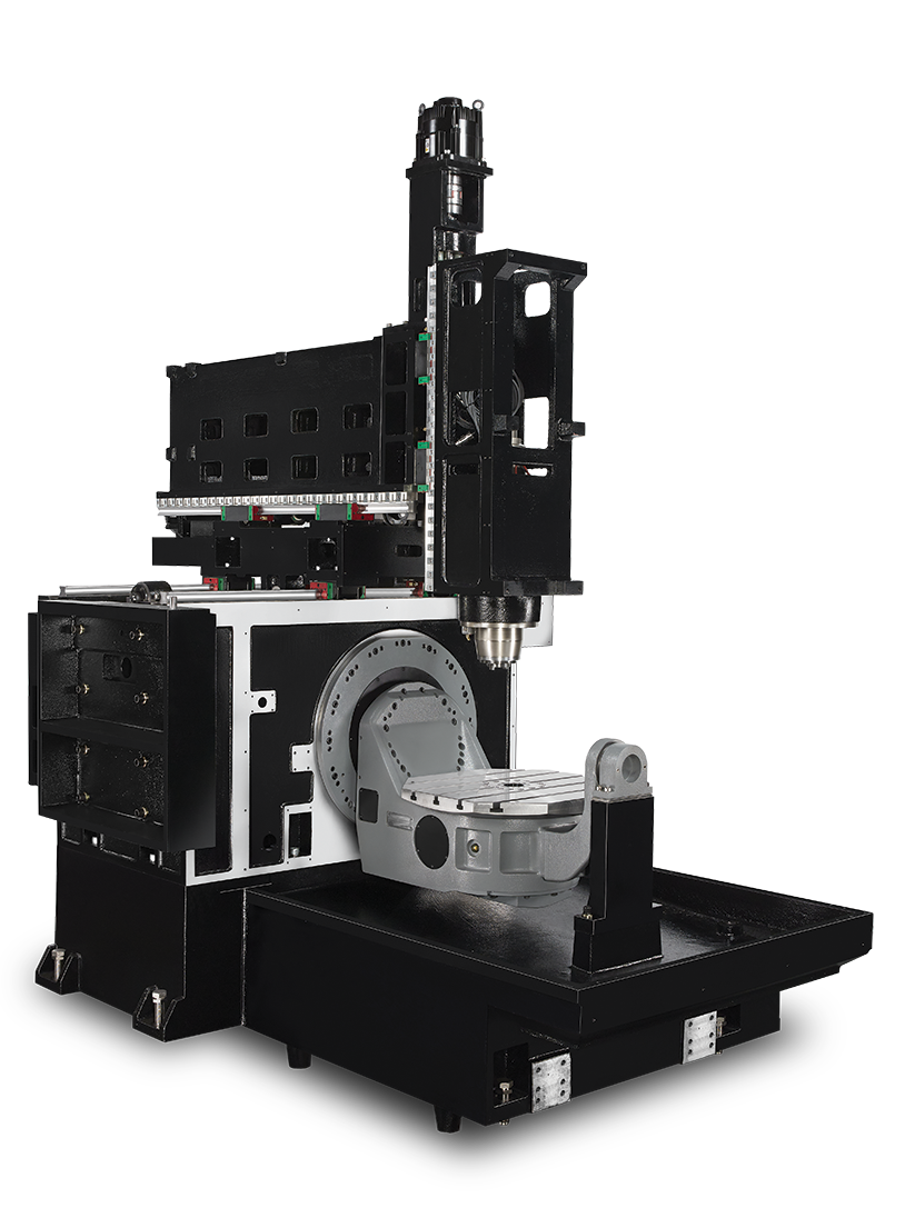

​​​​​​​​ 5-Axis CNC mill with cantilever design supports a wide range of parts.
The B-axis provides superb undercutting ability with a full 110° in both positive and negative directions. Solid one-piece cast iron frame optimized with both static and dynamic Finite Element Analysis (FEA).
The 5-Axis VC Series B-axis trunnion style configuration will allow for shorter tools to be utilized when cutting smaller parts. When cutting smaller parts on a traditional A-axis trunnion, the tools approach the part from behind the A-axis trunnion. This means when running smaller 5-Axis parts on larger machines, the operator is forced to use longer tools for clearance. Since a B-axis trunnion tilts around the Y-axis, the tool is always approaching the part from a safe direction and the possibility for interference is much less.
5-Axis CNC Hurco VC Series Cantilever Machining Centers
5-Axis CNC Machining - Cantilever​
  • Integrated trunnion table design provides more clearance in Z-axis and ability to machine heavier parts compared to 3-axis machining centers with trunnion table added
  • +110° / -110° B-axis motion delivers better undercut capability
  • Larger, heavy-duty roller ways on all three axes
  • Solid one-piece cast iron frame optimized with both static and dynamic Finite Element Analysis (FEA)
  • Yaskawa Sigma V Digital AC Servos
  • 5 axis/ 5-sided machining software features Tool Path Linearization, Tool Center Point Management, Transform Plane, 3D Tool Compensation, Tool Vector Input & Retract, Shortest Angular Traverse, 3D Import
  • 2 or 4 passage rotary unions for hydraulics and/or air
  • Electric, side-mounted, 30-Station swing-arm ATC
  • Full Enclosure with wide front access doors and fully contained tool storage
  • Angular encoders for rotary axes
  • Pistol-style coolant and air guns
  • Z-axis regenerative brake – no counterbalance
