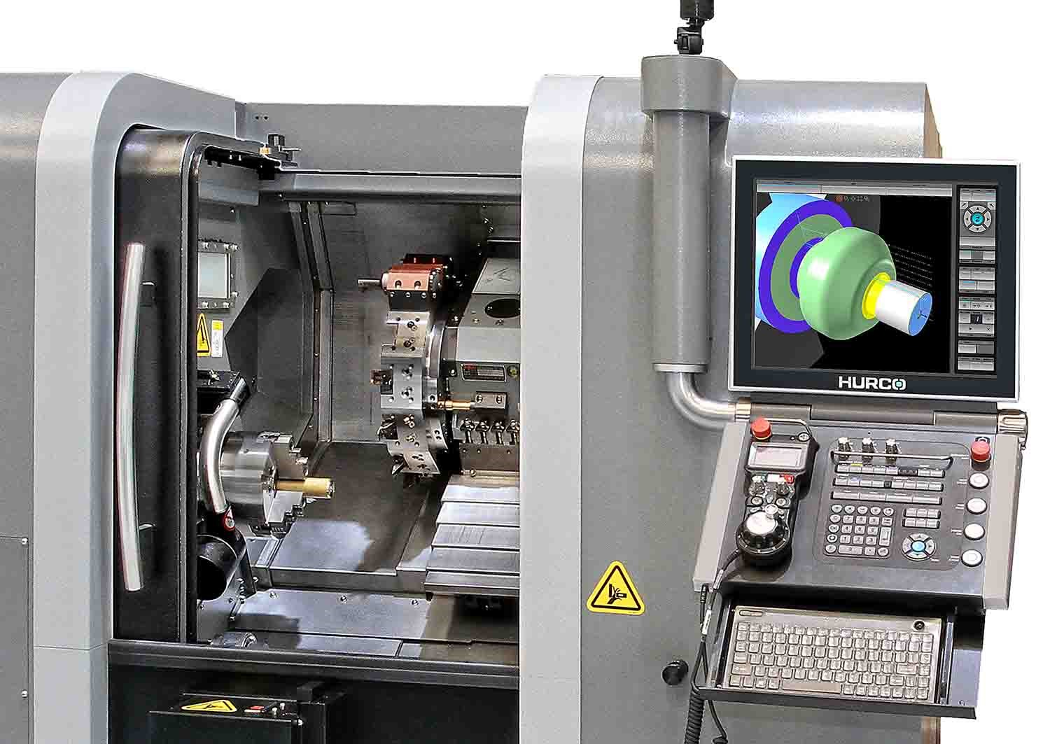

A primary reason for developing the TM Mi XP range, in addition to adding the superior features of the Max5 control, was to ensure that driven tool milling is smooth and accurate. The machines include a servo-controlled C-axis and the capability to deploy driven tools at all turret positions, allowing milling and off-centre drilling to be performed in addition to normal turning operations.
Two machines are currently in the UK, a demonstration machine at Hurco and another on trial at a customer's factory. The first machines available for sale will arrive late June 2020. They will be the new 8-inch chuck models which, compared with the former TMM lathes, offer higher spindle power at 22.6 kW, a spindle bore increased from 62 to 79 mm, a draw tube diameter of 64.5 mm, up from 52 mm, and faster rapids at 30 m/min rather than 24 m/min. Coolant capacity has also increased.
The new CNC system uses a multi-core CPU that allows high resolution graphics on the screen, comparable with those on Hurco's machining centre control. Patented Ultimotion dynamic variable look-ahead software is standard, ensuring that machine motions are responsive, smooth and accurate, improving surface finish, tool life and cycle times.
