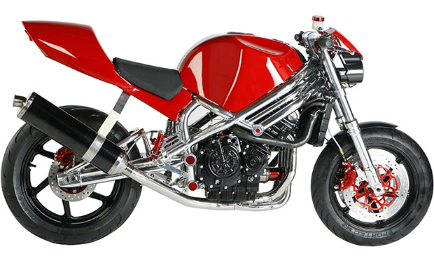

Based on the Honda Fireblade, BFO manufactures a kit costing around £6,500 plus VAT and, within a month, converts the donor bike into a bespoke motorcycle called the ‘switch:BLADE’. Only the Fireblade’s wheels, suspension, brakes, wiring and engine are retained; the rest is replaced in the makeover. The plan is to build 100 kits before moving on to a second donor bike, the Suzuki Hayabusa, and repeating the exercise in collaboration with international motorcycle stylist, John Keogh. This second bike is already attracting a great deal of interest following release of the initial artist’s impression.
