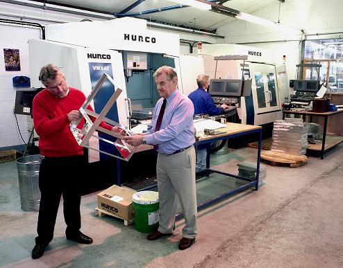

Blackpool-based Aerolux, a world leader in the manufacture of aircraft galley insert equipment such as ovens, refrigerators, wine chillers and coffee makers, has stolen a march on its two main competitors in Germany and the USA by CNC machining many components that were previously fabricated. Half of all prismatic parts are now machined from solid aluminium on two Hurco vertical machining centres installed in the Spring of 2004 and 2005 respectively. While safety-critical parts in aircraft are always produced this way to prevent the risk of crack generation, food-related equipment in the galley has traditionally been fabricated.
The benefits to Aerolux and its customers are considerable, as parts are quicker and less expensive to make by milling than by welding. Managing director, Ken Metcalfe, says that a fridge door and frame, for example, would require 10 to 12 hours in the fabrication shop whereas they are machined on a Hurco VMX42 in less than half the time. A further advantage is that components are more repeatable than when welded, which introduces distortion, so parts assemble more accurately from batch to batch. Moreover there are no welds to fettle, so a lot of finishing has been eliminated.

By the beginning of 2005, the machine was working flat out during the factory’s 10-hour daily shift. It had become so important in the Aerolux operation that a breakdown would have disrupted customer deliveries; and there was not even time to train more operators. The obvious answer was a second Hurco VMX42, which was installed in May together with an off-line programming station running WinMax software that mimics the capabilities of the machines’ Ultimax control. The latter’s intuitive touch-screen, with drop-down menus and second, adjacent screen for displaying a graphic of the component and simulating the cutting cycle, is used very successfully on the shop-floor for programming. The off-line facility will be used, in the short term at least, for new product development.
