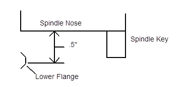

  2. ​Ensure Z Axis is fully Calibrated, then depress the Magazine Right Softkey then Start button. Next you will enter the "Secret Code". Do this by pressing "Enter, 1,0,1, Enter ". Carefully jog the Z axis down with the Jog Hand Wheel, to obtain .5" between the bottom of the "V" Flange located on the Tool Grippers and the bottom of the spindle nose. Refer to figure
  3. The CRT displays Z Axis position, i.e.; (Z Axis) 0.0000 (TARGET) 0.0000. Target is previous value if any. Press Store Z Softkey. This records the Z Axis's present position as the new Tool Change Height. Check at this point that (Z AXIS) equals (TARGET) and AT HEIGHT is back lit. Press Exit Softkey.
