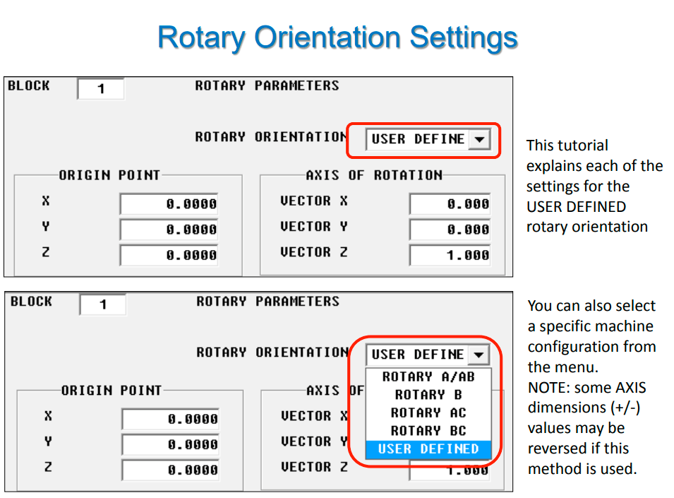

What is Universal Rotary and how do I program with it
Rotary Orientation
​The Universal Rotary program type is designed to operate on any 4- or 5-axis Hurco machine - regardless of the axis configuration.
The control will make the necessary movements based on the axes that it has available.
This means that Universal Rotary programs can be shared between many machines in the shop, and allows the operator to use whichever machine is available at the time…not just the machine that the program was run on previously.
Click here to download the PDF document about Programming with Universal Rotary.
This document includes:
  • Rotary Orientation Settings
  • Rotary Parameters are used to orient the cylinder
  • Axis of Rotation Settings
  • Zero Angle Settings
  • Cylinder Origin Point Settings
  • Cylinder Radius Data Settings
  • Tool Vector Angle Settings
  • Off Centerline Distance Settings
  • Machine Configuration Settings
