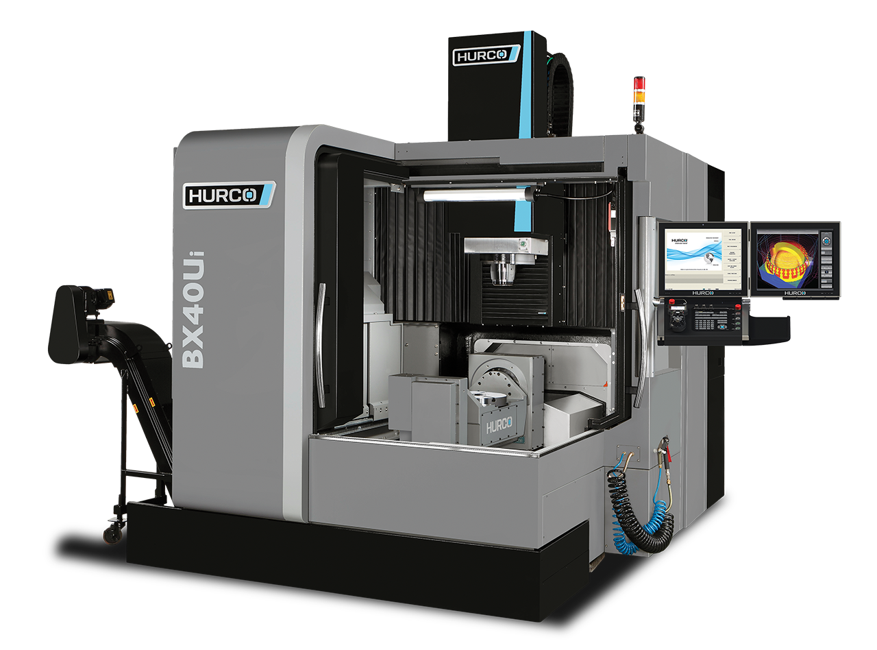

​​​INDIANAPOLIS – The Hurco BX40Ui 5-Axis CNC double-column machining center, with trunnion table mounted along the Y-axis, is the perfect combination of performance and flexibility. The ladder structure and double-column design provides extreme rigidity and outstanding support to the head casting. With an 18k motorized spindle and oversized linear guide rollers, the BX40Ui is perfect for a wide range of applications. Additionally, the bridge structure is isolated from part weight and operates in a stable and predictable manner. Exceptional cutting feed rates are achieved with patented high-speed motion technology called UltiMotion that simultaneously reduces cycle times by up to 30% or more and delivers outstanding surface finish quality.
The BX40Ui differs from other bridge-type 5-Axis CNC machines due to the integrated Hurco control powered by WinMax® control software and UltiMotion®. The control helps machinists and job shops be more productive and profitable by supporting multiple programming methods: conversational for 5-sided programming with no CAM system needed; NC for simultaneous 5-axis; and a Hurco-specific feature called NC/Conversational Merge that optimizes efficiency even further. The newest control feature called 3D Import is especially advantageous for Hurco 5-axis machines because the control software creates Transform Planes automatically for easy 5-sided conversational programming that eliminates data entry requirements.
UltiMotion is the sophisticated motion control system invented by Hurco that determines the optimal trajectory to run the tool, provides consistent programmed feed rates and reduces cycle time. With UltiMotion, cornering velocity is 2.5 times faster than conventional motion and machine jerk is reduced by half. UltiMotion includes up to 10,000 blocks of dynamic look ahead and is smart enough to adapt as required by the tool path. UltiMotion is different than the smoothing features offered by CAD/CAM software and improves upon CAM output by providing better handling of the machine mechanics and dynamics. All Hurco CNC machining centers are equipped with UltiMotion.

BX40Ui Specifications:
Table Size 13.7 in Diameter (348 mm Diameter)
Max Weight on Table 551 lbs (250 kg)
XYZ Axis Travel 37.4 x 21.6 x 19.7 in (950 x 550 x 500 mm)
Rapid Traverse X, Y, Z Axis 1,535 in/min, 1,535 in/min, 1,535 in/min
(39 m/minute, 39 m/minute, 39 m/minute)
Tool Type HSK 63
Peak Spindle Motor 47hp (35kW)
Spindle Torque 88 ft-lbs @ 2,800 rpm
Number of Tools 30
Machine Weight 20,723 lbs (9,400 kg)
