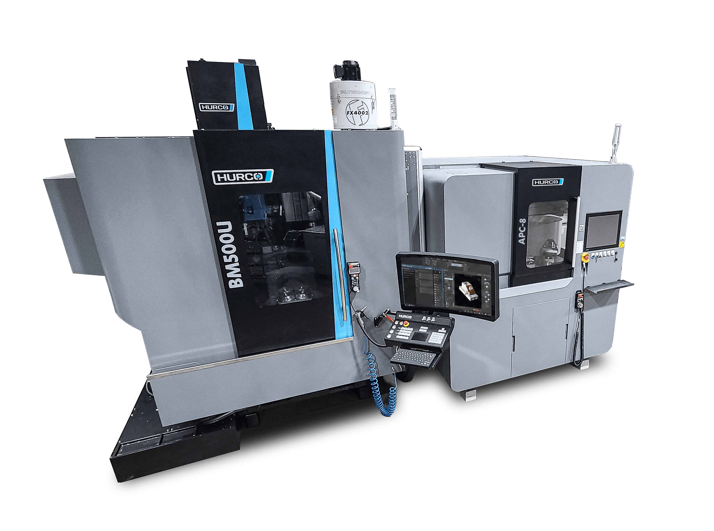

APC-8 Automatic Pallet Changer
Hurco's APC-8 pallet pool is here, and so is your lights-out potential.
Whether you're automating for the first time or adding to your existing lights-out capability, the APC-8 is an ideal way to keep your Hurco productivity humming all through the night. Talk to your local Hurco dealer to find out more.
  • 8-station capacity
  • 275 kg maximum workpiece weight
  • 450 mm maximum workpiece diameter, 400 mm maximum workpiece height
  • 8 pallets and Schunk Vero-S clamping station included
  • Vertical side-loading auto door
  • Runs on Hurco's Automation Job Manager software
  • Fully integrated with your existing Hurco control
